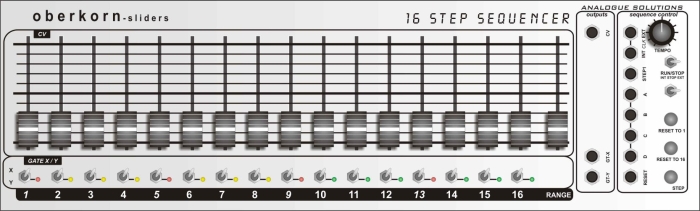

Analogue Solutions http://www.users.globalnet.co.uk/%7Econcuss/ are now delivering their new sequenser, the Oberkorn mkii. I have used it for some days now, and it is a really nice experience. It has 3 x 16 CV steps and 5 x 16 gate steps. One of them can deliver gate signals that can go on for more than one step. By combining them with the trig out, different rhythm patterns are possible. It can also be obtained if a LFO with variable pulse is width is used as an extern clock source. It is possible to reset to step one or step 16 for correct timing with other gear.
Oberkorn mkii
But one thing that really makes it fun is the four inputs that give access to the mux controlling the steps of the sequencer Using them, it is possible to create new patterns, that don’t run from 1 to 16. The jacks can be fed from the gate of the sequencer, or a random pulse generator or any other source. I have not explored the possibilities yet, just played around with the cables, but it is easy to see many applications.
There are two things on the down side: The highest possible operating frequency is not so high, so the use of it as a graphic VCO is limited to the bass register. And it does not sound so good either.
The second is the mechanical hardware: The electronics is housed in Analogue Solutions generic stand alone case. The front plate is aluminium, but the rest is made out of plastic, and it doesn’t give the strongest impression. There are no rack ears, even not pre drilled holes for mounting such things. So, for mounting it in a rack, some additional hardware is needed.
