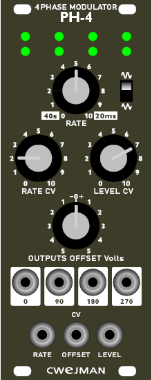

PH4 is a barber pole generator. It gives four separate LFO outputs with a phase shift of 45 degrees. Used for feeding four filters, VCOs or phasers it gives an illusion of infinite rising frequency. I guess it is supposed to be used with two of Cwejmans SPH2, a dual (or stereo) 14 step phaser.

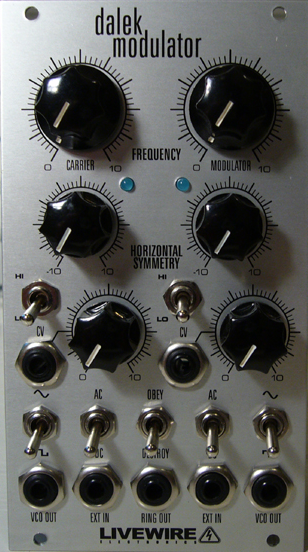

Livewire and Plan B have now split their cooperation, and work from different sites. Livewire has three new modules in the pipeline, although none of is are for sale yet. The Dual Bisell Generator is two slew generators, with adjustable slope and time. The Dalek modulator is two VCOs with cross modulation and one ring modulator in the same unit. Sound examples are not yet on http://www.livewiresynthesizers.com/forums.html?op=modulators but I guess it can produce some really wild and nasty sounds. The Vulcano modulator has the same principle, but uses two VC LFOs instead. Internal processing gives 10 parallel outputs, as sum, difference, minimum and the common wave forms.
