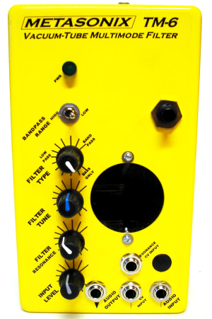

This modular report focus on two new modules: The Metasonix TM-6 and the Livewire Dual Cyclotrone.
Metasonix TM6
The TM-6 Multimode filter bears all the signs of a Metasonix http://metasonix.com/ product: it is yellow; unpredictable; and it can be a wonderful adventure or an audio nightmare, depending on what kind of attitude you have.
It consists of two band pass filters two or three octaves apart (depending on the setting of a switch). A rotary knob fades in and out the two band pass filters. When turned to 12 o’clock, the band pass filters are in series, with the treble filter first in the chain. It is not a true low pass filter, but it sounds like one. In low pass mode, it is possible to get that warm fat resonance at the top of the sound, that is associated with classic analogue filter. In band pass mode, the resonance can go into a nasty peak without warning; headphones are not recommended. The bass only filter is just the bass band pass filter.
Part of the classic Moog sound is due to the filter saturation. But it goes to unexpected levels in this module. The normal operating level for the filter is 2 volts peak to peak. But as the average VCO modular output is 10 volt peak to peak, turning up the input level knob full clockwise turns the filter into a tube fuzzbox. At the same time, the filter effect gradually disappears. With that, the resonance also decreases.
When the unit arrived, I was building a complex 10 voice patch that lacked a powerful lead. So I fed the filter with two sawtooth VCOs tuned a 5th apart. I used the TM-6 in low pass mode with the input at a level where the filter effect was on the way to get lost, and resonance set to just under self oscillation. The result was a fat, creamy classic filter sound, but with more organic fatness and power than any other filter I have used.
The band pass mode is capable of traditional wha wha effects, but at a wider frequency area. With the tube distortion, mimicking guitars of the 70s is quite easy. The sound is thinner than in low pass mode.
The bass only mode is capable of removing most of the audio content in a way that it seems like the sound source was deep under water. It sounds rather odd, more for the experimentalist than the Tangerin Dream wannabe.
Beside being a filter, I think this module can do a great job on being a wave shaper and analogizer for other sounds. The distortion created in it is warm tube square waves, and at full level there are only small traces of the original waveform.
The TM-6 is not so easy to handle, as the different parameters affect each other in an unpredictable ways. You can do a lot of knob fiddling and never be sure to find the sound you expect. It can never be tweaked to sound like something like nothing else; forget “The Moog sound”. It sounds like a Metasonix product, nothing more and nothing less.
It is expensive compared to other filter modules - $399 US from one retailer on the internet. As it is so unique in sound and handling, I think it can never be the first, second, nor even the third filter you buy for your modular system. But it can add things to your sounds that no other filter can. And as the Metasonix TM-1 waveshaper can double as VCA, it is now possible to build a modular with tubes in all steps of the audio chain, with a totally unique sound. But due to the cost, it is for boys and girls with both passion and money.
